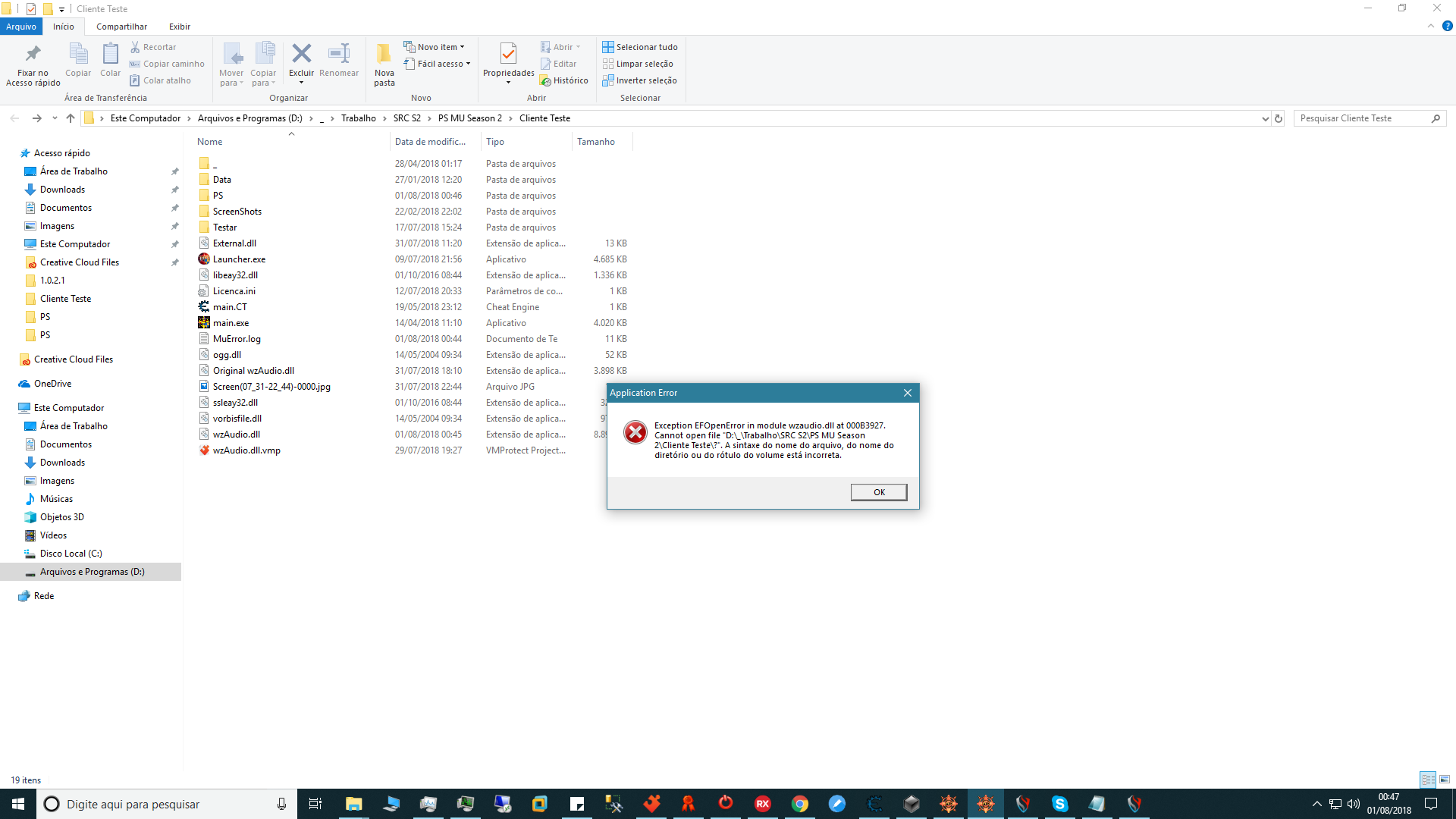

I'm have one issue after protecting my dll.
my current setup on vmprotect is:
memory protection: yes
import protection: no (since i use hooks, and if enabled it's impossible hook apis)
resource protection: yes
Pack the output file: yes
debugger: user mode + kernel mode
Virtualization tools: yes
I attached the image error on topic.
I believe is some string after protected my dll don't know what is, since on my dll i open .ini files.

- erro1.png (155.39 KiB) Viewed 15148 times

Do you use libraries like Detours, etc. that change your code at the startup?

Re: Problem after protect dll
DDetours and MADCODEHOOK.
The memory protection from VMPROTECT cause this error, how use it with DDetours and MADCODEHOOK?
After protecting my dll my hooks stop working, how procede? if not i can't use VMPROTECT.
I've disabled all protections method of VMPROTECT and after protect my dll api hooks like on send (ws2_32) stop work, what's the solution?
