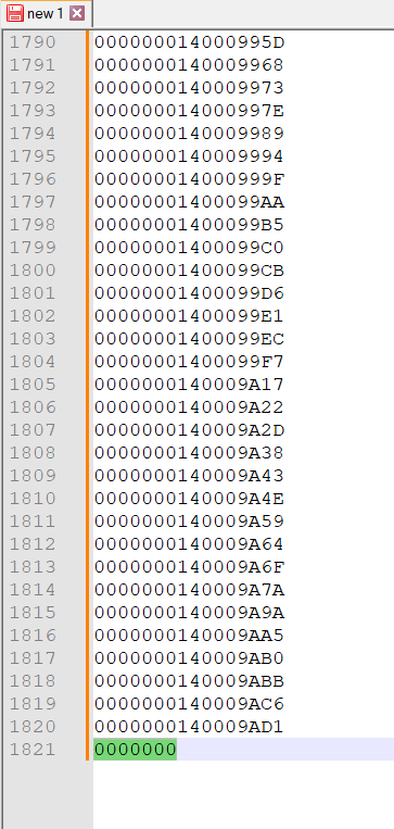

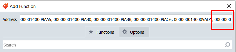

You can't select more than about 1800, sometimes much less depending on the start addresses. I need to select around 60,000 if this is possible
Once you select a lot of methods, you will see that it starts rolling over, and the last entry is "0000000"
I copied to Notepad ++ and replace , with \r\n to make it easier to see what is happening
See attached pictures

Re: Verbosity for "Error Invalid Address"
It seems TextEdit has limit of buffer size, so the latest "000000014000xxxx" was truncated to "0000000". Anyway, adding of all functions is useless.
